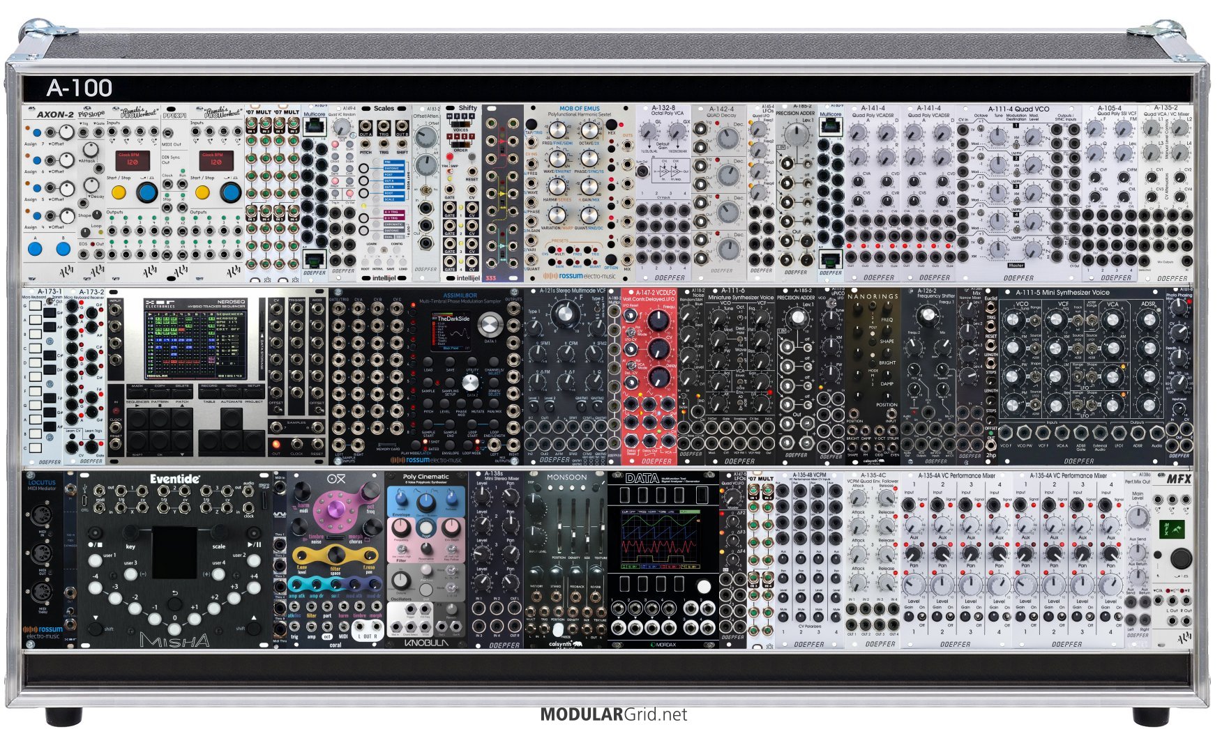

The main modular. Planning took forever. Lots to test. So far, yikes it sounds big.
I tried to keep the most typical connections to be close enough for the Little Yellow Wires.
I'm using a Deftaudio midi hub down next to the Misha, but MG doesn't have their listing.
Note use of the two Doepfer A-180-9 Multicores. The cool thing is that you can use two ribbon cables and connect them from the back.
That gets 14 lines from the note clocks on the left over to the voice modules on the other side, without draping a dozen wires across the box.
The 'ethernet' connectors still work for connecting other synths.
I have to go back and study the Misha and Nerdseq manuals a bunch more.
Hopefully someday I can tame that Mob of Emus. They are always ornery.
This build is more 'play notes' oriented than 'funny noise' oriented, with lots of sequencing and step counting from the left side.
Turned out nice, and formidable too. Stereo four voice polyphonic, and eight parts is a stretch, but possible.
Sounds great so far and it even stays in tune with itself, mostly.
The GO cases and internals are pretty good, plasticy but sturdy enough. Their joining bracket is a little wonky.
The joined pair is solid, but in no way road worthy, and the whole thing is way heavier than it seems.
Despite it all being Behringer, the ARP side sounds distinctly different from the Roland side.
Glass-ey vs. woody maybe? The 2500 modules also tend to have way wider output ranges than the System-100M Series stuff.
