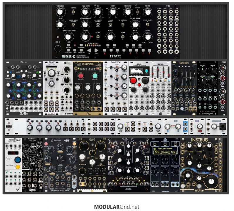

i'm pretty far to finish my first intellijel performance case. mostly for using it as an ambient machine.
the mother32 is not in the case, its standalone used together with the case....
What do you think of the module selection and the balance of Voices, Modulation, and Utility modules? Do you feel like there's anything this case is really missing, where you'd say, "You're making a mistake by leaving that out"?
and would you go in this one with morphagene or arbhar, and why?
Thanks for any suggestion
NS
For starters, it'd be good to link the case rather than just a picture of it. I recognize ~half of these modules by the front panel alone, but linking the case itself makes it easier to get a closer look at the ones I don't know or even just kinda-know in order to give better advice.
What is your plan? How you you intend to control/sequence the synth? Are you looking to make washy generative soundscapes, crafted melodies, or techno beats?
Are you using this with any external equipment besides the M32?
