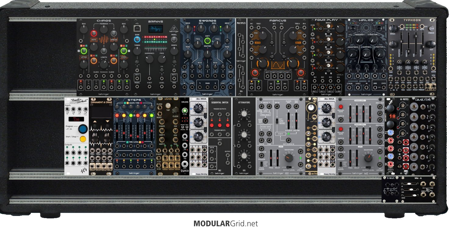

Notes: This is a combo of stuff I already have in the case (Behringer Eurorack Go) and stuff I don't yet have, but plan to.
The bottom right module (Level Fixit) is a placeholder for a Pulp Logic 1U to 3U converter (w/ built-in passive attenuator) that holds the two 1U tiles underneath it (need to grab an actual output module eventually). I picked that one because it was the same HP as the adapter & passive. Will likely swap Behringer Clones for actual MI modules or better clones over time.
Likely need to adjust layout for better organization / optimization.
You certainly have many modulation sources.
So many modules, so few VCAs...
