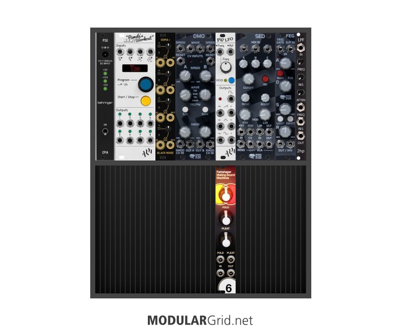

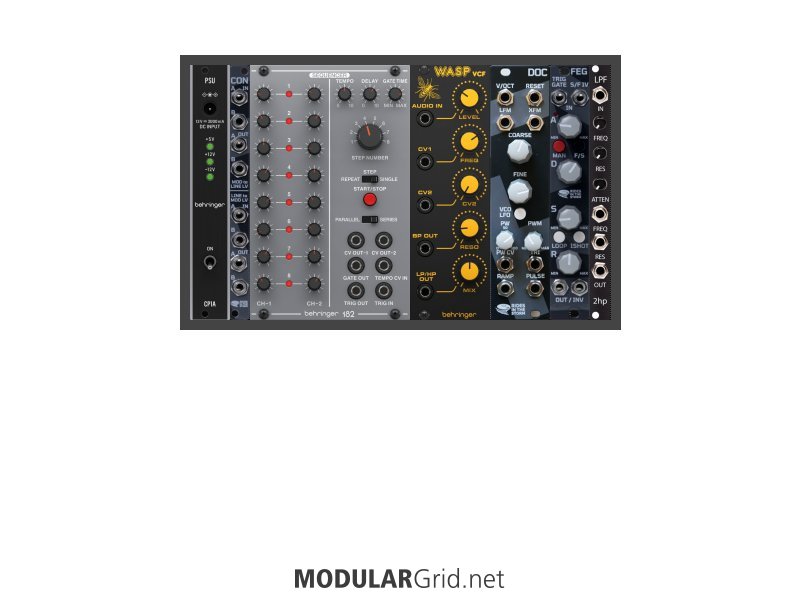

Hi folks! This is supposed to be a eurorack geared towards acid bass and similar sounds.
I would like to use it in conjunction with my Polyend Tracker Mini (which I would use for the rhythm base).
What do you think? Do you have any other configurations to propose, possibly cheap (I would like to stay under €400 but I don't know if it's feasible)
Thanks!
https://modulargrid.net/e/racks/view/2879715

just another take:
2 voices + filter with mixer and drive
or 1 voice + waveshaper + filter with mixer and drive

just another take:
-- VONDENFUNKEN

I think you need a VCA, otherwise this will not work. Ideally you want a second envelope too, otherwise your filter(s) and VCA have to share.
If you are using the polyend tracker, do you really need a sequencer in the case? It's very large.
Sweelinck
For a truly acid sound, very close to the 303, you might also consider the TB-O module.
See: https://modulargrid.net/e/ge0sync-synth-tb-o
@wishbonebrewery has posted several videos on this topic in MG.

thanks to everyone for the advice, really!
I'm trying to figure out how to spend relatively little and learn how to use it for real. I would buy the sequencer to understand how it works, space is not a problem because I design the case and print in 3D
