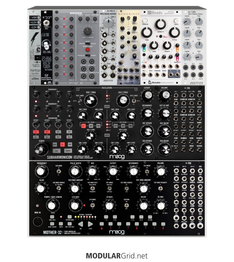

Hi new here and to the world of Eurorack, and I know my life will never be the same. I don't plan on going down the rabbit hole completely (famous last words haha), as it is more an addition to my current set up and I am a guitarist producing ambient music. I just want to have something to generate textures, sequences and happy accidents. What I have in mind is very basic. I already have a Moog Mother-32 and Subharmonicon. My dad is making me a nice timber three tier rack and I want to fill the third (top) tier with some modules and connect them all together no wider than 60hp (thanks for the idea Loopop).
So I am guessing some euro channel, a power supply and a mixer are the essentials, but thinking a couple of MI clones like plaids, marbles, rings ya know - the standards which are probably pretty cliche for hard core users but I really like the sounds. I have a board of full pedals so no needs for effects, plus I have some synths, drumlogue etc. Would be great to get the opinons of some much wiser in this space any advice is really appreciated, this looks like a great community.
  • image below is what I have in mind so far
  • is the power supply a good choice? Current should be more than enough.
  • this may be a dumb question but does the ribbon cable carry audio?
  • The sequencer module is probably overkill given both Moogs have one but I'm not sure what else would compliment this little rig any suggestions?
6hp left?
Doepfer A-185-2v Precision Adder.
You can then have one sequencer transpose the other, in tune, up or down,
and then share those new notes to that nice top row.
The power supply is fine.
The modular ribbon cable never carries audio. Just power and ground,
and sometimes, one gate for event on/off, and one cv, usually for notes.
Those two Moog sequencers are very different animals and can play nice together,
but the Subharmonicon is a demanding instrument to tame and integrate into a mix.
It's harmonic based, and always brings it's own special notes.
Spectravox is even weirder. For me, both of them are more for seasoning than a main course.
If you like that three-tier Moog format, consider maybe two Mother32s might take you further.
That'd be fun.
Thanks for the feedback I will look into the A-185. I have had the two Moogs for a while and pretty familiar with the subharmonicon. I really like it and have used it as the basis for a couple tracks, using one sequence for a bass line and seq 2 to form a pluck sequence over the top. From watching some videos it seems the Spectravox and Labyrinth are even more experimental so not for me. I thought about a second M-32 but decided to go for more variety.
Yeh the reason I ask about the ribbon cable is to consider how I am going to connect them all together, as the Moogs are in cases. I will take them out and mount into the rack so I can take advantage of the power supplied by ribbon cable. Looks like it's going to be cable spaghetti for the audio tho.

Nice set up, you've given me things to consider and some great ideas. My dad has made some wooden end cheeks so I'm good in that department.
Regarding the PS can it be powered at the back? I see the socket on the front panel but is there also a back connection? I'm OCD when it comes to hiding cables.
Do you have a modular grid list of your modules to share? If so that would help me in doing some research on other modules. Thanks for your feedback.
You have to power it from the front.

This is a nice one:
https://modulargrid.net/e/stochastic-instruments-4-33
"What can music be?"
This is a little cleaner and cheaper too.
The Behringer seq does more, costs way less, and can act as another system clock.
The nanorings is smaller. works the same, and is easier to find.
Finding a Beads, or any authentic MI module, is tough now. Do you already have them?
I put them in an order so they can often interconnect with those nice short yellow Doeper patch wires.
Love those little yellow Doepfer wires.
Have you considered an external sequencer? I have an Oxi One mk1 which I'm extremely happy with ^_^
Also, I think you should consider some modulation sources, like LFOs. Pam's Pro, which is part of @noodle_hut setup, is a great utility for this.
You might also be interested to look into low pass gates (I'm personally a fan of LxD here) to combine with the various audio outputs from your Mother-32 and Labyrinth, and might even a submixer to combine multiple audio signals together (I have the A-135-2 for my Mother-32).
That said, you're on a great start, starting with semi modular synths are a great way to get into Eurorack, and with the pedals as effects you should have a lot of options audio-wise ^_^
If you want to tuck away power cables, you can consider a power supply that's inside the rack. It's a bit more hassle than just buying something like a uZeus though.
And remember to always double-check that the power consumption requirements (at the bottom of your rig) is supported by the power supply. I read somewhere that it's good to have 10-15% "free" capacity, but I'm no expert on this.
