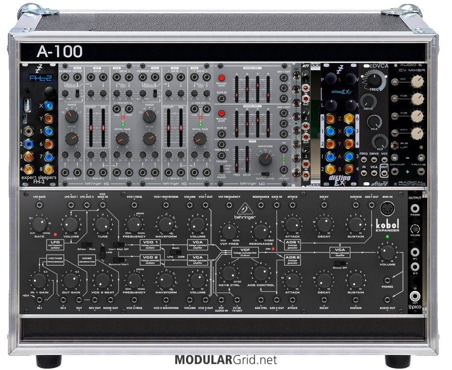

Hi all,
I am hoping to get some feedback on this 84HP rack design. It's built around the Behringer Kobol semi-modular which I already own.
I have plenty of experience in pro-audio, but not necessarily in modular - so I am hoping you're going to spot something obvious which I have missed, or suggest how I could approach this differently.
I swing between techno and ambient so it's really got to cover all sound design bases!
Here are my goals for the rack:
1. Sequence and MIDI control the modules from external sources (I also own a Keystep, a Digitakt and Behringer Edge)
2. Play the 4 OSC paraphonically
3. Mix audio from all 4 OSC and the Behringer Edge (The Kobol OSCs can be mixed via its own internal VCA)
4. Have enough FX and modulation options to mangle the sound.
5. Have the right utilities to be able to route and control signal flow
6. Be able to monitor directly from the rack, or send audio to an external destination
Reason for chosen modules:
* MIDI, paraphonic playing of OSC, plus clock divisions etc handled by ES FH2
* Modulation and FX handled by Disting EX and A2Vproject cDVCA (plus a common VCF)
* Audio/CV mixing handled by Radical Freq CV/Audio Mixer (might need more inputs?)
* Utilities handled by passive mult and triple attenuator (better to have buffered mult?)
* Output to external handled by Pico Out.
I would be willing to swap out the Behringer 100 modules if there is something that makes better sense space wise. But the fact they combine VCO, VCF and VCA into one module is quite attractive.
