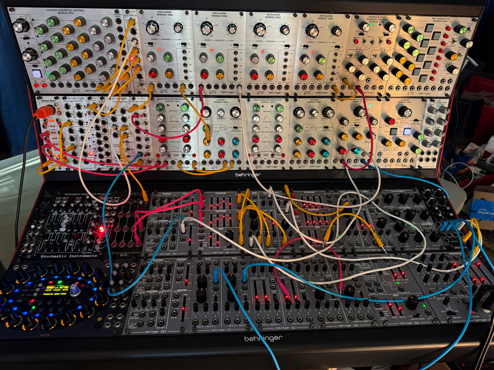

Turned out nice, and formidable too. Four voice polyphonic, eight parts is a stretch, but possible.
Sounds great so far and it even stays in tune with itself.
Despite it all being Behringer, the ARP side sounds distinctly different from the Roland side.
The GO cases are pretty good, kind of plastic-ey, but sturdy enough. The joining bracket is a little wonky.
Still testing and learning what it can do. No video, but I thought I could share a picture of it.

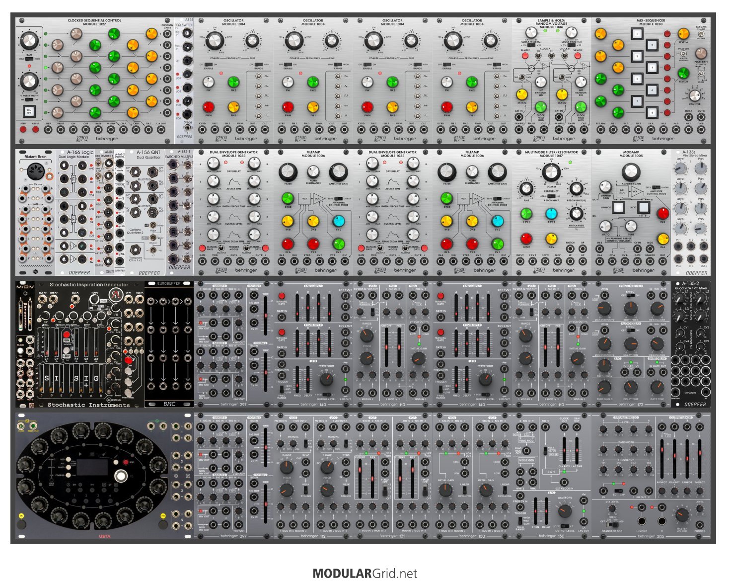

Here's the layout:
I tried to design more horizontally and vertically this time, a challenging constraint.
Vertically, 36 hp for event generation, 16 hp for envelopes, 64 hp for voicing, and 24 hp for mixing and output.
Horizontally, each row can also work as a separate synth, standalone from the others.
It is kind of delicate to transport, surprisingly heavy to move and really needs 8 more envelope generators.

Thread: IdealRack
You certainly have many modulation sources.
As an exercise in Modular Grid, drop a quarter of those modules. (so that's 26hp to sacrifice)
Conceptualy split what's left into two, planning each half as a viable synth, whatever it does, on its own.
Now, with that newly freed space in the middle, fill it with utility and glue modules.
Adders, offset/attenuators, active multiples, submixers. Stuff like that.
The precision adder lets you switch multiple oscillators/modules up or down octaves without spreading oscillators out of tune with each other.
Flipping a switch to raise or drop an octave is a convenience compared to re-tuning with a knob, and more accurate than most active multiples.
You can also use it to transpose a sequence to another key with a second sequenced cv.
The first channel lets you ease in with an attenuator, so you can add a bit of wobble or other modulation fun to multiple voices.
Or you can use it to goose several modules a little bit into tune, all at the same time.
I guess it's value depends a bit on if you are going after playing notes 'in tune' with something else or itself.
I don't mean that negatively.
I know a lot of synth musicians don't want anything to do with that, and that's ok.
We forget after doing so much in digital, that analog is so squishy in its tuning.
The A-185's "precision" keeps combining or switching 1v/octave cv-s dead on. Really handy all the time.
Doepfer A-185-2v Precision Adder

Thread: The pile
I’ve collected a bunch of Behringer modules over 4 or so years
and I wanted to get them off the shelf and give them a home.
I build mostly for auto-generation, I’ve added enough other parts to make it workable.
It sure used a lot of knurlies.
I tried to think vertically this time across all four rows and not be just two cases glued together.
Worked out to 36hp for note events, 16hp for envelopes, 32hp for voices, and 24hp for mixing.
Stereo! No fx modules! No midi!!
Two big wall wart power supplies! :(
It turned out very nice. I wish it was as big as it looks, but it's heavier than you would think.
Everything tests ok. I’ll try recording tomorrow.

Do you need two note and trigger outs from midi, or just one set?
Do you need this box to be able to send midi out too?
This arrangement could make things easier.
Input and signal generation on the left. A multiple between to share those signals. Voices to your output on the right.
I moved the power supply to be better out of the way of patch cables.
The 110 needs those two envelopes, so I kept it nearby.
The 2600 vco doesn't have a vca, but you could put it into the 110's 2nd vcf input.
The 121 filter at the end lets you tame and shape your final output,
but also gets you a 3 x 2 mixer to combine your audio generators,
or blend the 2600 vco's vaveforms.
I kept the CU1A output, but it's kind of terrible.
You have to power it from the USB-C input, it's not hooked to the power supply.
So with no usb input power, there's no output audio and no headphones.
Just a dumb design. Nothing but trouble.
(and the 921A Oscillator Driver isn't applicable here)
I added the 903A random because there was a 4hp hole,
and it's cheap, and you don't have any random noise fun.
If you want the sequencer to track midi in, you'll need an interface that supports midi clock/sync out.
There's loys of them available.
You would need two EGs that trigger on end of envelope, and your A-141-2 VCADSR / VCLFO does that, but only does one. You would need a quad polarizing mixer like the A-138J to blend the functions, but I didn't spot that here. And then I guess something else to mix and invert the outputs.
But it's good because if you drop the A-141-2, you only have find 6hp more to sacrifice to fit a 20hp Maths.
Oh, you wanted to get rid of some modules? We don't do that here. We only get more modules and larger cases.
An impressive build, but what we'd really like to see is your giant collection of patchcords!
Looks better in person.

You could benefit from a good mult to share your hard-won generated signals.
I like the Synthrotek MST '07 Buffered Multiple @ 4HP. Best $99 you could spend here.
I think you can get lots out of what you've shown here already.
I've moved things around, mostly to help with using those little short yellow Doepfer patch cables.
