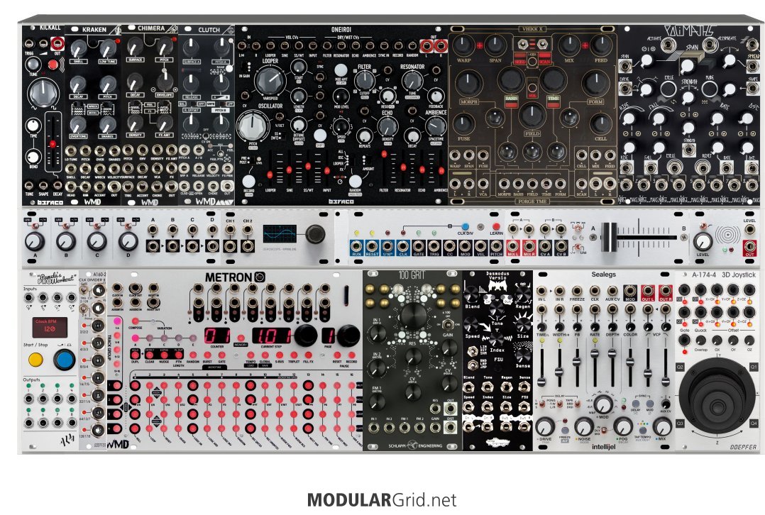

I have no clue if this is a viable rack... please help
Hello,
Here are some quick thoughts/suggestions as first steps after giving the rack a look over.
1. I would recommend taking out either the Oneiroi or the Vhikk X (if you are set on keeping the percussion modules). Those are both complex voices and you won't be able to take full advantage of their complexities simultanteously, in a modular sense, in this size of a case and/or with the amount of modulation capabilites present here. With the freed up space, you could put in more modulation, VCAs, or mixers, which I highly recommend.
2. You could do without the Doepfer clock divider. The Pam's Pro easily already has that covered, unless you have a very specific purpose in mind for it. That also gives you more space for modulation, VCAs, or mixers.
3. As an alternative to 1 above, you could remove the four percussion voices to free up room instead (which is what I would do, personally). If you did this, it would also make the Metron less relevant as a gate sequencer, so you could change to a different more melodic sequencer or a smaller sequencer for just the Oneiroi and Vhikk X. You will definitely need more mixing capability if you keep the percussion modules.
4. I don't see a way to control your final output, so you will also want to consider fitting an output module in there somewhere. You also have stereo sound sources and stereo effects, so a stereo mixer and/or output module with at least two stereo inputs is probably warranted.
I gave a go at a rack using key modules from your rack. I think this would be a lot of fun to use. There could probably be some improvements, but I think this would get you to a lot of fun exploration. Mix with a drum machine/sampler externally for percussions.
I hope some of that is helpful!
