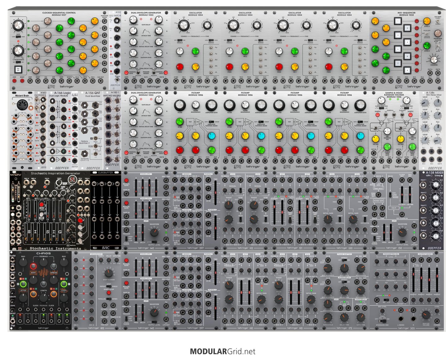

Singular, here's what 'planned' can look like.
The main difference between this configuration and yours?
Mine's real, in the other room right now, making music.
You asked "can this make music".
I answered your question directly and honestly, no, it's a mess.
You asked why and I told you many reasons, honestly trying to inform.
Didn't listen a bit, and instead gave back some nonsense bs about your artistic intent.
Then you start sea-lioning the thread members.
I am disappointed that you're only a poseur,
and that I spent valuable time on replying to you.
I suspected you were, but I forget myself sometimes.
You're just a clueless dummy, wasting our time, and we all know it, sonny.
You can get a lot more of that polyrythmic stepping with a Doepfer A-160-2 and it's only 4hp.
You get 8 derivative clocks and its prime number mode makes for very nice repeating patterns
where the cycle repeat isn't evident. Spits triggers or gates. Helpful lights. Comes in black if you want.
Two of them are fantastic for generating interesting, interweaving patterns.
I don't have any of those modules so I don't understand what they do right now,
but I'm sure they are learnable and can all do something interesting.
A lot of those things in your design aren't available anymore.
And sure, you can play a simple oscillator like a penny whistle and make music.
But filling a box with random complex modules does not make it a performant instrument.
A car with some impressive engines, but no wheels, no gas tank, no transmission, no seats.
How are you going to mix those audio sources? Coordinate the clocks they want? Blend CVs?
There's several stereo modules, but no way to fully mix them and use the functionallity you would be paying for.
What signals are you willing to throw away going from stereo down to mono filters and wavefolders?
Monophonic and/or polyphonic? Stereo and/or mono? End-to-end stereo is expensive to run and always a pain to plan around.
Many of those modules want to be fed envelopes, but in that pic I can't see many envelope generators or LFOs.
There's too many sequencers, with too few voices for them to feed. Maybe pick two at the most.
And again, with the kind of music I think you have in mind, you have to think about your clocks.
They're everything. Will you need clock dividers/multipliers? What's going to be the usual master clock?
Don't forget, you'll also need a distributed shared reset for the sequencers and counters to establish sync on start.
Also, you have to imagine it with patch cords draped all over it, in a live setting, with challenging lighting.
This one seems a mess.
Redo that whole top row. You can't get those 5 voice modules anyway.
Might as well just use a Rossum Assimil8tor or ALM Salmple for drum duties.
But I do like the Moog follower/filter, that's my favorite thing in the rack.
That, and the SIG module above it.
I have a couple of SIG things and their modules are unique and thought provoking.
If this had to be built and made to work, I'd dump that keyboard and fill the space with a NerdSeq and their added I/O.
And an output mixer.

The 4 VCOs sound good, and seem stable. They'll knock you down, like ARP an oscillator should,
But the Behringer circuits don't like to share CV, and multing them all to a stable pitch is elusive,
so as fun as those passive multiples are, at least two of the A-182 mults have to go.
The 1047 filter has an instability, and not in a musical way if that's your primary VCF.
Like all filters, I have to learn it, but it's cranky.
Why didn't they add two clock outputs to the S&H module? They're right there.
Instead, it takes two clock outputs to sync it. Grrr.
I've used the 2500 series sequencers with Doepfer QNT for a long time and they always just work.
The vactrol filter is just a panel filler until the filtamp arrives.
The A-171 is cool, but doesn't earn it's 8hp.
The mutant brain is going too. Adding MIDI isn't feeling like a good fit here.
The next build gets an active mult and clock dividers.
I also found that I'm missing not having a noise source.
My envelope and VCA situation is dire. Juat two envelopes sharing one gate/trigger? Lame.
I've got some Behringer series 100 modules that'll work, but was going for that shiny 2500 aesthetic.
Because of the smaller scale, the aluminum, the 70's look, and the kind of light-duty switches and knobs Behringer used,
I'm not sure if this is kind of an ARP 2500, or a really nice PAIA 4700.
I've wanted to build one of those one day too.
The Behringer 305 works ok "for the money" but mine sits on the shelf.
The EQ section flattens the dynamics and harmonic content and to my ear, it sounds dull, cheap and non-musical.
A mono EQ in a stereo device is kind of an odd feature anyways.
The little thing that I thought would be useful is the 220/440/880 tuning reference.
Mine hasn't ever been close to pitch and it drifts and flutters in frequency even after warmup.
So it's useless as a tuning ref. Maybe I just got a bad one.
I understand the value proposal, and the merits of an all Series 100 box, and I do like my other Series 100 modules,
but this one is a disapointment, especially considering the space it takes up.
A 16hp module, like the rest of the series, that dropped the EQ and pitch ref,
and added output level modulation for controlled fade of everything, would have been better.
Could have been worse, they could have added that sad Klark-Teknik delay and reverb.
I suppose Behringer had to "emulate" features of the Roland system, so this is what we got.
As a whole though, the Series 100 is an impressive bargain, and that's what they do.
Getting this out of the way, yeah, Behringer. I know. I feel plenty bad.
Over the past years I’ve picked up most of these B2500 series modules, but was always…uncomfortable with mixing them in with other stuff. I love the work the industrial designers did on the series, and they do work well. Somebody at Behringer really loved this project and it shows.
Instead of keeping them on the shelf, I wanted to unify them in their own case. So I continued the frugal route with a Behringer Go case with 2x140hp and an adequate power distribution layout.
(I also suspect that the 2500 series is out of production and some B2500 modules might start getting scarce.)
So this will be my August build. The Mutant Brain gets me polyphonic midi and clock, and the Doepfer quantizer tames the sequencer to real notes. The four Doepfer 182-1 switched multiples is my cheesy 16x8 matrix switch substitue.
I’m cautious when using passive multiples, but if they were good enough for Al Pearlman, they're good enough here.
It’s missing some things. It doesn’t have a noise source, and a quad VCA would have been nice, but there’s no more room. It’s a very meat-and-potatoes synth build. Nothing exotic or esoteric, but that’s always been the essence of the 2500.
Looking forward to sitting in front of it and playing. Should be a pretty thing.
What do you think?
Having 16 guitar cables snaked out of a rack seems problematic.
That's a lot of weight pulling on a module or two and probably why you havn't found one yet.
The Mazzatron module pushes the 1/4s out the back or the module.
I don't know how that could work very well.
I know you've got a plan, but you might be forced into having submixes.
They're exceptionally made, and panel thickness hasn't been noticeable,
but for a little more ($20 more at Perfect Circuit right now), I'd go with their QAM Active mult.
The Frap Tools Usta sequencer would work great with the voices you have.
And it's beautifully crafted hardware. Just a gem.
For me though, fixed step sequencers can get boring after a while.
NerdSeq can do everything, if you manage to figure it out. Don't know if I ever will.
If you want unique/musical/odd/depth, Eventide Misha does really fun things driving a three voice system.
Seems like a random collection of modules in a random placement.
It'll make noises, but as an instrument, it's unclear what you're after, beyond a display of stuff you want.
There are potential voices there, but mixing the mess together is unclear.
You need more active mults. You have all of that signal creation but it can't be shared easily amoung modules.
Put the Pam's all the way to the left as your master clock/reset, then mult it out to the rest.
I'm unsure why you chose the Frap Tools module in the 2nd build. Not really what it's for.
Dump the modules from 2hp and keep looking. Save the frustration.
I wish that the Disting wasn't the interface nightmare it is. Such a good idea, but sadly, never stays long.
Are you going stereo or mono or hybrid? Are you sharing clocks with something else? Will you need midi?
You going to play actual notes? It's hard to tell, is there a quantizer in there someplace? Do you need one?
Both racks look chaotic to patch and play without some sort of signal flow plan.
It's no fun weeding thru a drape of patch cables all of the time.
Avoid using stackable and LED cables.
Don't know what to say about those two joysticks...
Simplify. I suspect that y0u'll never get to even a quarter of what those higer level modules do, just on their own.
I'd start with less than half of those higher level modules and put more time into building out
your clock/reset, the CV/gate/trigger distribution, and your mixing, and then focus on learning the modules.
p.s. Modular Grid has become essential to my work. It's a terrific and unmatched resource. They're great.
Every rack wants a Pam's Pro Workout as a master clock.
A Nanorings instead of an original Rings will save you money and 6hp, and work and sound the same.
Calsynth makes a nice one, as does Michigan Synth Works.
Because you're looking at the Doepfer MIDI modules, maybe consider the a-190-5 Polyphonic MIDI controller.
It does what the a-190-2 does x4, and provides many more tricks with the kinds of voice modules you have.
If you stick with the A-190-2 MIDI module, note that the A-140-2 ADSR can be automatically triggered
by the 190-2 if they share the same bus. Saves two wires, overrides with patch cables.
Have it live next to the MIDI module.
Mults. Look at the Frap Tools 333 ProAudio Sum and Distribution module. I use it in almost everything.
6hp, cheap, solid, dead on clean and accurate, and handy for adding CVs (and audio) together,
and then mult-ing them out. I also like the Rides in the Storm QAM Quad multiple.
Very well made at a good price.
You could use more meat and potatoes. Will that A-119 comparitor earn it's 8hp of space?
The A-121-3 multimode filter is 4hp and could help tame and shape some outputs.
Next to that, an A-145-4 quad LFO, because everything could use a little more wobble.
Far more utility in 8hp than the comparitor.
I'll hate myself for this, but a used Maths is going for around $290.
A new Behringer Abacus is $59. Ugly as sin, built to a price, but $231(!) cheaper.
I feel so dirty now.
Modules from 2hp always seem like a great idea until you use them.
I think I could use one more filter up in the upper right FM stuff, but I don't know what to get rid of.
As interesting as the Chaos Marbles clone is,
I think it's real estate is kind of wasted because its functionallity is duplicated elsewhere.
It's also pretty ugly. Behringer makes me feel dirty.
Support for the Doepfer ribbon controller and an A-111-6v will probably go there instead.
Spectravox is fun, but dark science.
Don't forget the more "boring" utilitiy modules.
Needs some active multiples. You want to spread that Pam's around.
I like the QAM from Rides In The Storm.
The Doepfer A-18302 Offset/Polarizer comes in handy to scale and trim things.
You might want to add another flavor of filter.

I am kind of puzzled by the arrangement of this.
The oscillators on row 3 get mixed on row four, then you have to go back up to row two for VCAs and EGs,
then take their outputs ?? back down again?
Put the i/o interface and the midi inputs up in the left corner where the fixed filter bank is,
next to the sequencers, because they're both your note event sources.
I'd sacrifice some oscillators for more filters. Are there any LFOs at all?
I try to keep things left to right, with a sort of normlization of proximity, so I can use short doepfer yellow wires as much as possible to avoid a drape of wires over everything. I'm building in 3 rows, so what's above and below also matter.
I also try and put a mult after signals that are valuable enough to spread around (if there's room).
Almost all of the racks I see here look like random modules in random positions, that they think are cool.

I'd put Maths in the lower left corner, before the percussion voices,
and put the quantizer and Circles to the left of the oscillators and envelope generators.
Avoid having wires draped everywhere. I love using those little yellow Doepfer wires.
The Wasp and the 106-5 SEM sound different, but kind of the same.
Substituting an A-101-6 Opto-FET Filter would provide more colors.
You are going to need more multiples.
If you had to sacrifice something for a 4HP Rides in the Storm QAM, what would it be?
Mounting a module from 2hp on the end of a row is asking for trouble.
Always a wonky fit and really difficult to get your fingers in there to tune it.
That voice is already covered, I'd drop it, and with the spare space already,
there's your 4hp for a QAM.
Circles (and techno!!) wants a clock. I know it's costly, but I'd drop the A-136 waveshaper,
and put a Pam's Pro Workout in the far left someplace. Maybe near a mult(!).
The A-136 doesn't give back much for the space it takes up anyway.
Pam's can do a lot of the things the noise generator does too, plus 7 other outs,
in the same space. It could also help with the lack of LFOs here.
I've settled on grouping by voice sets, not by having a row of oscillators, a bank of envelopes...
I did that at first, but now my clocks are grouped together up in the left corner, and audio/midi io in the lower left.
But I try to have modules in the middle near each other that I can link with
those little yellow doepfer wires as reasonable "defaults".
I also need less wires using Doepfer's CV and trigger bus lines in three of the groupings.
I sort of see it as: here's my bass and percussion sections, this group does keys, this row is guitar/lead,
and this is the mix to output. I can always cross patch to oblivion, but I don't have to every time I sit down to record.
