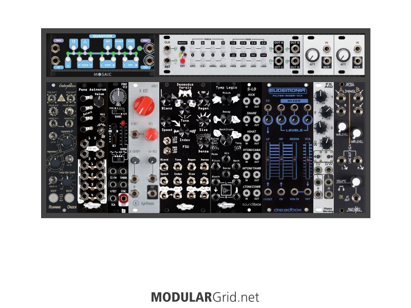

Here is an iteration on my palette travel case, for minimalist techno. Please let me know your thoughts, things you'd change, swap etc.
It's basically a "complete" standalone drum machine. Pony VCO will take care of Leads, Tymp Legio will do the kick and some round background bass notes. Pony VCO will go through filter and Desmodus and then into Tymp, for some Ducking. Then the S-LD will provide 3 samples which will be mixed and filtered via Eudemonia. Then I'll mix what comes out of Desmodus and Eudemonia in the Xoh. Pons asinorum will provide enveloppe for Pony and LFO for melody (through the Mosaic quantizer) plus 2 LFOs for modulation via the 1U attenuators in the top right corner. Steppy will sequence Lead, Kick, "snare" and Melody LFO reset. Running order will take care of HH and another perc.
That's pretty much it. I think it will be fun.
